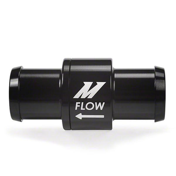

Sal, suppose you were to plumb the bottom drain of the petersen can back to the oil pan? You could put a one way check valve in the line so any crankcase pressure keeps it closed but off throttle it would allow the oil to flow back.
