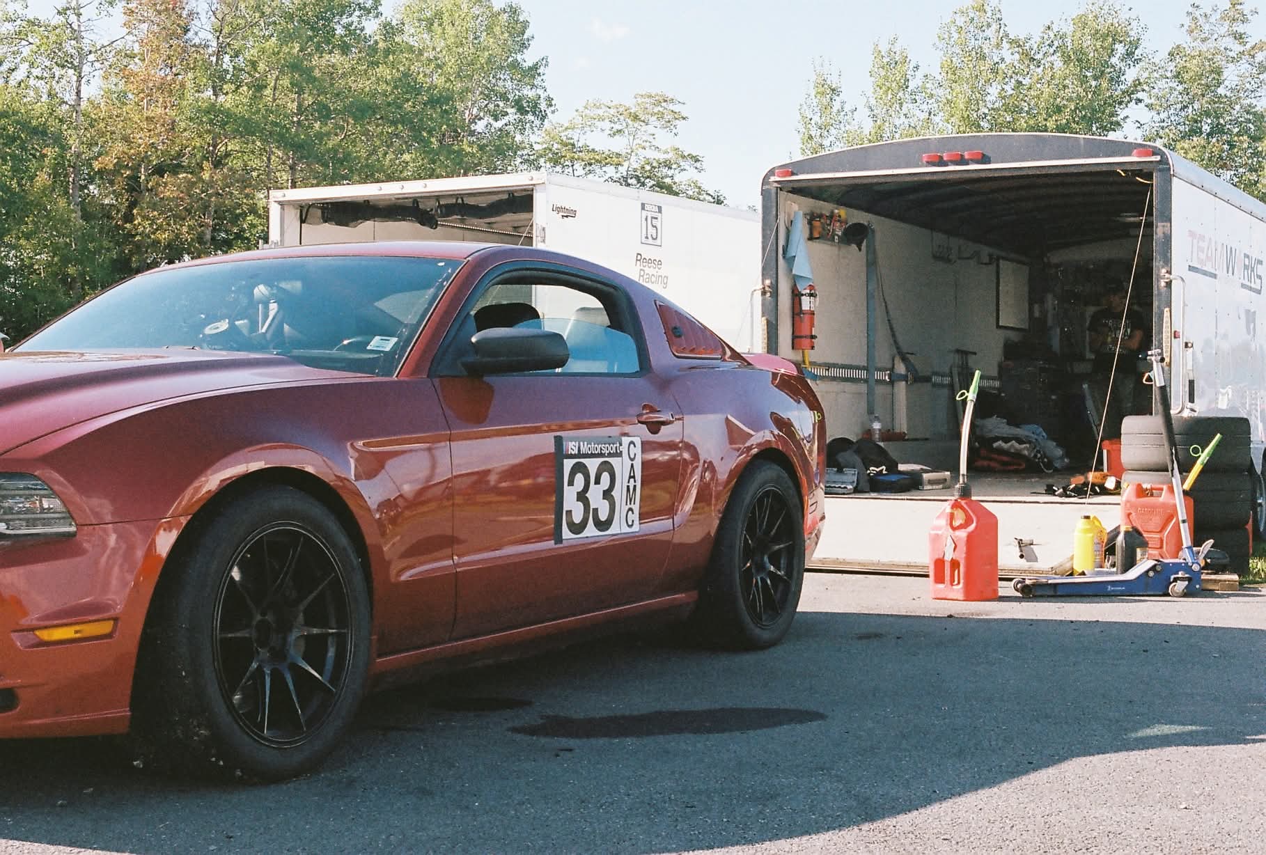

I finally did what everyone has been telling me to do from the start. HAVE 2 SETS OF TIRES and oh my. What a beautiful day it was when I finally did have 2 sets 7E149D41-305C-425A-824A-B8A07F9B4B3A.jpeg
Toyo T1s for the street and maxxis victra RC-1s for track and autoX
Got very lucky and got both sets on the used market for cheaper then 1 new set street/track tires
