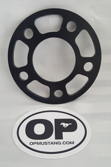

5mm (actually 4.7mm)
6mm
6mm
Thanks Coz! Vorshlag is saying I must use longer wheel studs with a 5mm spacer. Would you agree for my Boss 302?
Correct. You want to make sure you have enough thread engagement with the lug nuts.
Yes! but I think more to the point,,,, do not use the stock studs at the track
Mad Hatter is correct. Especially if you are running wider & stickier tires.
On your S197, as long as you can get 10 full turns of engagement you are in the clear. At a minimum we want to see a full diameter of engagement on studs. The S197 studs are 1/2"-20 thread, so to achieve a 1/2" of engagement requires 10 full turns.
For the S550 with it's M14-1.5 threaded studs, you will want 9.5 full turns.
