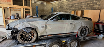

A Ford Mustang Mach 1, built as a dedicated track car. The interior is completely stripped and a cage is going in soon. It runs an MCS 3-way coilover setup, which led me to reinforce and weld the rear upper shock mounts at the chassis. The rear towers are also tied together with a brace inside the car. In addition, I’ve installed several drivetrain stiffening components and the car is tuned.
Brakes are a Mov’it setup. Tires are Nankang CRS in 285/35 R19 square.
I’m driving the car pretty hard. I’ve already had a major crash (guardrail contact) and rebuilt the car afterwards. It’s currently running its third transmission.
