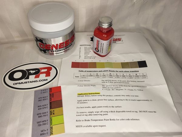

Do you know how hot the rotors are getting? Use temperature-indicating paint to find out (I'm sure it's available from a race supply shop in your country). With that knowledge, you can use the temp.-friction charts many race brake companies have available to pick compound.
Do whatever you can to increase cooling to the rotors. Are you properly bedding in new pads & rotors?
You can knock the glaze off the rotors with 180-220 grit sandpaper or an aggressive Scotch-Brite pad. Use a dual-action sander if you have one. For the pads, lay a full sheet (approx. A4 paper size) of 180-220 grit sandpaper on a sheet of glass or very flat workbench, and move the pad around it in a figure-8 pattern keeping the pad dead flat. Clean both the rotor and pad with brake cleaner on a clean rag. Make sure to properly re-bed the pads & rotors.
