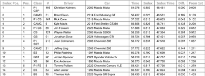

I've run two events since my last update. First event was my first ever Pro-Solo where I was in P2 after the morning runs on Saturday and then the car just never went faster and I couldn't put down clean cone-free runs. When I got home I gave the car a once-over and found that the front driver's side swaybar endlink had backed off and disconnected. I assume I ran all or most of the event without the front swaybar which is why it was driving so poorly.
I was able to fix the endlink and moved the front bar to a 2/3 split to go a little stiffer up front to try and keep the car responsive and maybe transition in a little corner exit understeer without having to make a rear bar change. Showed up to the event and found a very very fast course. In the end I was hitting my 9,000rpm rev limiter in 2nd gear and with my tires that's pushing around 84mph. Car handled much better and the overall pax results show how much of a big aero/big tire/big power course this really was. Finishing 3rd on PAX and racing 1st heat before the course got cleaned up and rubbered in shows the potential in the car when it's not partially disassembled. Only 2 Miata's in the top 10 and one of those was last year's national champion in CSP.
