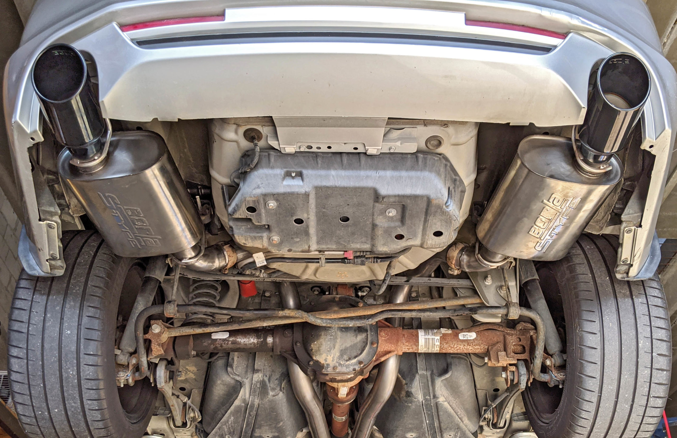

Hey guys,
Part 3 is now live:
Project Budget 400WHP S197 Mustang Track Car: Part 3 – Dyno Testing Borla S-Type Cat-Back Exhaust and Tune
" Despite achieving our 400 WHP goal, we installed a Borla S-Type Cat-Back Exhaust to further increase power, reduce weight, and improve the sound of our Mustang. We also found a bit more power in the tune and conducted a few air intake tests."
In the article:
-Borla Install
-Dyno Borla Exhaust vs Baseline
-Dyno K&N Air Intake with the lid ON vs OFF
-Dyno K&N vs JLT Cold Air Intake - the results will surprise you
-Dyno Overlays: Stock, Tuned Stock Intake Manifold, 2016 Mustang, 2018 Mustang, Boss 302
-Billy
