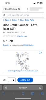

rear brake caliper options?
found these, they may be worth a try.
