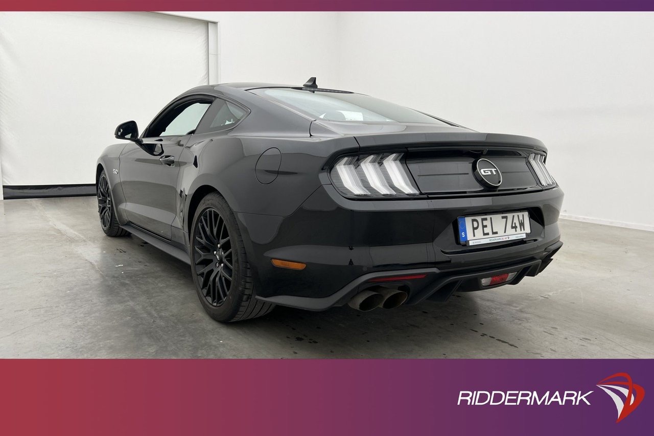

A couple of months back I bought a S550 Mustang GT 2020 (10R80).
Its my first Mustang and actually my first American car but Im in the start process of trying to build it too a quite fast but versatile track car..
As a background Im a real rookie to Mustangs but been racing(Circuit and TimeAttack) and building a Porsche before on a quite high level.
The thing is that in the US the Mustangs are super common but over here in Sweden the are only known for running of the road all the time due to really bad handling... ;-) That was quite impelling to me since ive been reading up on them a bit and realize they we have some hidden potential here to scare and potentially surprise some Porsches at the track.. I set my goal pretty high and the idea is to be able match a Porsche 991Gt3RS at the track... I think going after a 992 would be to much of a ask but a 991 should potentially be doable...
Any way im right now in the process trying to figure out the recipe for doing it but the issue with mustangs is not that is hard to find parts, its the other way around with to many options!! ;-) ;-)
Ive been "stalking" threads from FlyHalf and others on the forum but not written anything since im a rookie with not much to add to the discussion but eager to learn a bit more and think I picked up a little from your great and fast builds on the forum, especially FlyHalf..
The recipe in my build right now look like below and I would be super grateful for some suggestions, objections, tips and tricks!
Mustang GT 2020 PP2 EU model
Engine/transmission:
Mishimoto trans-cooler
Mishimoto main cooler
Mishimoto 71C termostat
K&N catch-can
ESS G3X supercharger with G4-IC
WG controlled boost to get a little more midrange and less top-end.
Arcane dual pump fuel system
1000CC FIM injectors
E85 fuel
Boundary Racing Pumps Billet Oil Pump Gears; MartenWear
Boundary Racing Pumps Billet Crankshaft Timing Sprocket
X-Pipe
Cat-delete
Wengard tune for engine and gearbox
 Idea is to run aprox 700-750hp on track and try to keep the cooling in order which Ive seen is really hard on the 10R80(Next step is potentially a RSA built transmission).
Body:
GT500 vented hood
GT-style rear wing
Ducktail rear spoiler
Front splitter
boxed coolers in the front.
Wheels:
Velgen 20x10 front
Velgen 20x11 rear
pilot sport cup 2 305/35/20 front
pilot sport cup 2 325/35/20 rear
Chassie:
Whiteline front swaybar
Whiteline rear swaybar
Whiteline vertical links
Adjustable Toe-link s rear
BMR Rear Camber Adjustment Lockout Kit
Maximum Motorsports Caster/Camber Plates
Coilovers not bought yet but the idea is Ohlins Road & Track, what do you think of those? Also some suggestions on spring rates would very much be appreciated!?
Overall around chassie im very confused because of IRS braces etc and other stuff that I never seen on a Porsche?!?
I'm also not sure what else I should do to get the most out of the chassie with out re-doing everything Ford built, im not sure what give the most and I dont want to through money in the ocean that does not give anything useful.
Its also a lot of stuff sold for the IRS back-end but not much for the front?!? Any ideas suggestions?!
What do you think overall, what have i forgotten and what am im doing wrong?
