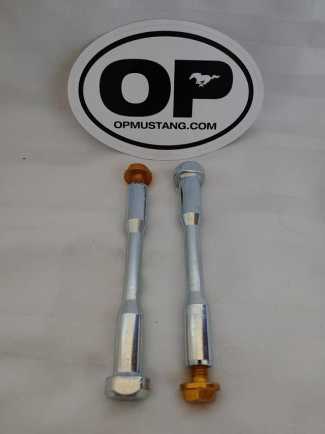

Ah, that might be a you thing. I put that part on last, and before I fire it through, I always make sure to seat that properly in its little rectangular place first, then pull it through, and then tighten it up.
More like using the same hardware to much times I think. But yeah definitely a me problem. Still something that could happen to the Brembo's that probably wouldn't happen on AP or more track focused brand.
Yea I do the same as Patrick. I put it on last. It requires very little torque spec. I seat the rectangular bit and tighten with hand/ratchet on opposite(inside) side. I change before and after every event and no where near having that part damaged. Maybe you just got it wrong one time and then repeated use made it worse.
but if we have people in here cutting record times on the same calipers for 2+ seasons at least, I would think they are more than capable. Hopefully you get yours straightened out
edit to add: if hardware is the issue you can buy new hardware for $25. If you bought new hardware for every weekend of the year, you still come out better than a BBK.
