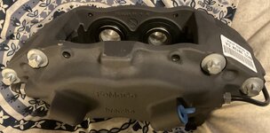

So when I started this thread the 6 pot s550 setup was actually cheaper than the factory s197 track pack setup. Now that is not the case. Even the 6 piston motocraft calipers on roc auto now cost more than buying OEM 4 pot brembos. The 14” rotors seem a little cheaper as well. So that’s the direction I am heading in, for a few reasons.

My use case is 200tw tires at 275-295 front max. My 5.0 will only have an intake and tune. 400whp max. My car will only be HPDE, street. No TT, etc. The factory 4 brembos seemed to take the guys at Vorshlag pretty far. They will be plenty for me.
