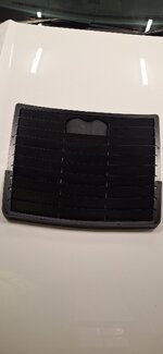

Over the weekend got to start modifying my bonnet vent. That manifold sits high.
You probably already know this, but Steeda sells engine mounts for the S550 that lower the engine height. They used them on their own "Silver Bullet" naturally aspirated drag car with that intake manifold to get it to clear the hood.
You probably had to ditch the strut brace to run that manifold, right?
Actually ditched the brace for the camber plates but it was going to go for the manifold as well. It was really a case of what got installed first.

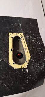

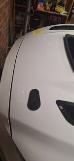

Picked up some aerocatch latches for a good price as i have seen them for proverbial drug money on the internet.

Debated the first option marked on the red tape but didn't like the amount of curvature the latch was going to have to deal with. Found a thread on here, surprise surprise, and the sideways option looked good and away from my vents.
Now the fun part, there are 3 layers of material at that point. That wasn't fun but it allowed for a nice small hole on the underside. A cutout on the top side and some serious WTF cutting and grinding of the inner layer a few mm under the top skin to allow the clamping piece to fit and be partially wedged to get the screws in without needing access from underneath.
Seriously the first one took a day of trying various things to do the cutting and pulled muscles in my back. Not happy Jan. Pretty sure that's an Australian only reference to a phone directory add. Link here if you are really bored,
Needless to say the second one only took a couple of hours.

Good work! Just a small note…
Keep an eye after a few track days on the striker. The red ones are aluminum and I’ve seen them bend. If it does it may benefit you to swap out with the steel one
