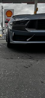

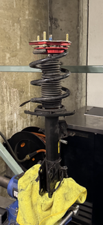

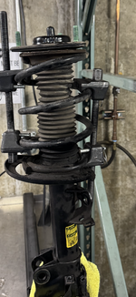

Finally got to ordering new Vorshlag camber plates and am planning to install them myself while retaining the OEM struts and springs on my base DH.
I'd like to run 19x11 wheel setup with 305/30R19 tires square. I spoke with Vorshlag on the phone, and they indicated I should be able to gain roughly an additional 2.5° of negative camber beyond the factory maximum adjustment which is around negative 1.3 degrees, and therefore get over -3° front camber with the plates. Based on that, it seems like the extra camber should provide enough clearance for the 19x11 front wheels and 305s without needing any additional modifications.
A few questions i'm trying to better understand before installing
  • Any fitment issues running Apex 19x11 ET26 wheels with 305s up front? Any rubbing or clearance issues at full lock?
  • Anything specific to watch out for during the installation?
