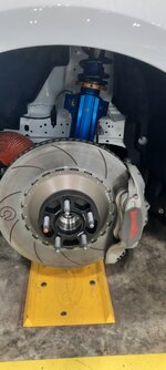

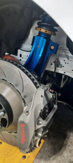

Getting ready to jack up looking at camber definitely looks decent at factory specs and you could definitely fit more tire under the opening IMG_1763.jpegIMG_1762.jpegIMG_1761.jpegIMG_1764.jpeg
Dang it your making me want to buy the R now i had talked myself out of it
I see the brakes are 4 pot i think it comes with 18” wheels?
I need to see one up close

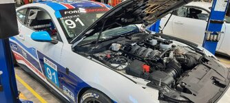

Sorry, missed your question. Mine are the earlier version that came on the FP350S from 2017. Same concept as the Dark Horse R. Just not as fancy. Watson Racing where clearing out stock and had them on special so i grabbed a set. They were a bargain at the time.
Yes those are nice. The DHR are a bit more expensive that vorshlag but i like the spacer repeatability etc. But i might need new plates. Won’t know till i cut i guess see if i can move them more
