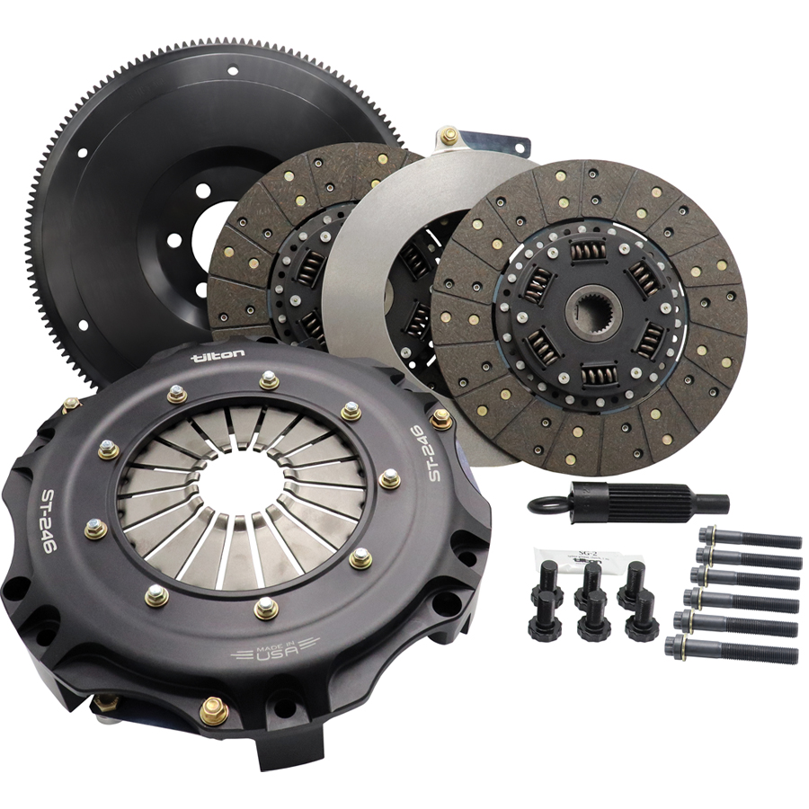

I got the Exedy Hyper-Single, but my second choice would be the Tilton ST line (fittings for both MT-82 and Tremec). For @Fabman I might look at the full-race 3-disc OT line vs the street-strip 2-disc ST line, but it might be worth a phone call to them to discuss particular application and get their recommendation for both disc count and facing material.
