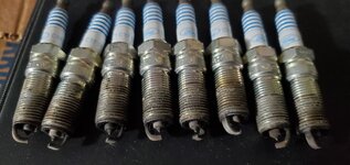

  • New Motorcraft spark plugs were installed at build time, 10K miles ago and when I pulled them out they were pretty dirty. Not ruined but lots of carbon. Replaced with new NGK iridiums.
