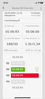

First session the R10's started getting the pedal hard in just 4 laps. Still did 1:07.011 in that 4th lap. This was good for a first session. I got out of the track and just get the tire pressures hard. However the only other car on track got into a nasty crash lucky the driver was ok but the car not so much though fixable. It took us an hour to clean up the track so the weather was already hot.
Also when back on track after a crash you always have something on your mind especially with brakes that act up. I did 1:06.93 in that session which was my best time for the day. Theoretical best was 1:06.6 though:
The rest of the day I spend playing with settings as the suspension was feeling really soft dropped down to -10/-12 clicks but the balance was just not there the front was very slow to turn in and the rear was oversteering on exit though the overall body roll was feeling much better.
I plan to move 1 click back to -11/-13 and probably stiffen my front swaybar.

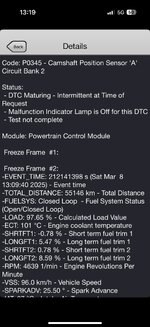

I noticed the car was running ruff so I read the errors turned out I have a P0345 code:
Last season on Serres I did get a P0349 code that disappeared after cleaning it. Same happened here however I decided not a great idea to continue driving it with all the issues.

1. That Oil consumption is excessive and I'm guessing it's causing the P0345 errors I'm guessing is the dreaded Valve cover leak so will order GT500 aluminium valve covers and wonder what else should I do while in there ?

The Oil issues and to an extend the P0345/P0349 errors Camshaft position sensor bank 2 (Driver side) might be caused by a leaking valve cover which is a common issue on the S550 I have a passenger side catch can but not a driver side one so considering Serres is Clock Wise track while Dracon is not and the issue is on the left side and my car is pulling 1.5G in corner it may be just slashing oil through ether the IM or valve cover and causing excessive oil consumption and more importantly oil pressure drops. Ether way I'm guessing the valve covers will be coming off as I need to first get a better understanding of the issue and 2 to make sure a known issue is addressed. I just wonder what else to do while in there ? I'm thinking and least do the chains and probably the FP version of the cams phasers (this will also address to an extend the P0345 errors as the FP version requires less oil pressure to work).
The P0349 error last season went away after Serres and didn't come back until this track day at Serres as a P0345 error this time. My guess is the error come out because of lost oil also the engine was not sounding happy ruff idle which may indicate that error ones the error was removed and oil added I didn't get the error back on the road back home which was also the case last time out. Again it might be losing pressure may be sensor on it's way out or an electrical problem (alternator going bad ?) My dealer will be helpless to diagnose that or an oil leak in such extend so will need to figure it out.

Hey H,
I had a P0345 Friday afternoon. This is after I replaced the CPS in November for the same thing. I'm wondering if I only get the code when in Track mode...is Track Mode incompatible with my tune? It was really cold Friday so I was in normal and Sport mode most of the day. My first session in Track Mode...P0300, P0308, and P0345. Same as November. Spark plugs looked good in Nov.

Keep me posted as this needs sorting out prior to my next outing on track. I plan to do the GT500 aluminium valve covers. Do the timing chain while in there and probably buy the FP version of the CAM Phasers:
As well as new cam position sensors.
