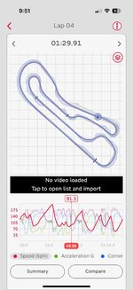

That lap was 1:31.05 so actually was the lap that give me back the title of fastest Mustang on Dracon since this is not official timing event I will need to wait till 27.09.2025 Ford Fest to be able to officially claim that title.
setting a lap time of 1:29.91 Top Speed 205.56 km/h or 0.03 seconds faster than the S13.
