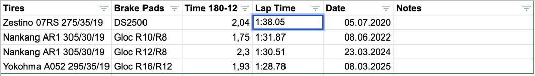

And Serres where the times are for 180-120 km/h because the apex speed in 1st corner is higher than 100 km/h:

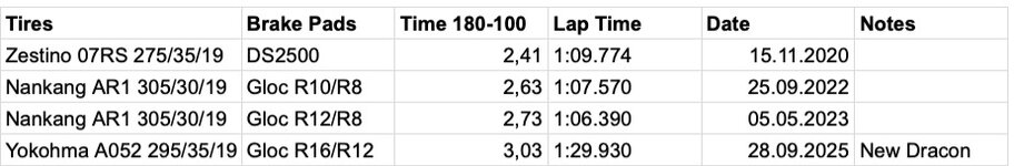

What is painfully obvious from that data is that with less tire grip and OEM Brake Pads (Ferodo DS2500) my stopping times were actually lower even though my lap times were slower. I think the R12/R8 time on Serres is actually me doing something wrong or more Ice mode but ether way it was actually higher than anything.
With all of that data and the knowledge that the OEM ABS in this cars has some limitations over 1.2G of braking I decided to switch pads I actually bought a set of Ferodo DSUno last year prior to Dracon closing for resurface but didn't manage to put them on the car so decided to give them a while with oem DS2500 rear pads.
So new brake fluid cap, fresh Castrol SRF and brand new pads went on the car on 28.10.2025.

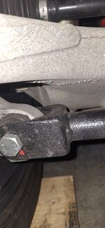

With regard to your knock in the rear end, took me a while to find this one. The toe link on one side was looser than the other so would rotate and hit the bearing in the aluminum arm whilst driving. Hit a pot hole and clunk from the loose strut bolt (knew where that one was) and the another from the rear of the car. A quick and simple fix was a medium sized cable tie with some polytube. Slide the tube onto the cable tie and warm the tube slightly on the cable tie and wedge it between the toe link and arm and wrap the cable tie up and around the bolt. It becomes a bump stop and stops the clunk. A month of cursing and thinking i had something in the chassis rail before i found the source.
Sorry for the crap photos, car is on the ground when i went out to grab some shots.
View attachment 106652 View attachment 106653
You are 100% correct it's from my toe links but I run steeda ones that the bearings in them are shot I guess. Still thinking in what direction to go for a fix on this one.
These are basically brand new and one side is way looser so allows the arm to rotate freely where the other side requires force. There is no play in the joints themselves. If you jack a corner up and pull/push on the bottom of the wheel and get a clunk then i'd agree the joint is worn out. Otherwise twist the arm and see if it hits the hub like mine. Fingers crossed you don't need to replace them. Hate having clunks that i don't know what is causing it. Have got very familiar with my left front strut nut coming loose.
When I press down on the car I got the clunk and it's the left side that is doing it more than the right side. My dealer said that it's the joint that is causing the issue they say it's not a safety issue and it's part of the game. So I'm leaving with it. But yeah overall will probably order OEM ones new as I have the same noise with my originals so it is what it is but I will check the bolts as that's a great shout the Steeda ones use nuts to get them tight so that might be an issue.

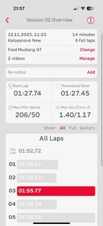

This was the lap. I'm experimenting with the new format that Racebox provides for Video Overlay but I managed to do a lap of 1:27.740 which is the fastest lap an American car did on the new Dracon Layout. I was so excited that with so minimal prep the car dropped 1.6 seconds compared to Ford Fest 25.
And with a Theoretical best in this Session of 1:27.4 I know a 1:26 should be on the cards in the feature.

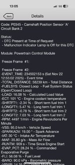

First time I got this error was back in March of 2024 when I money shifted the car to 10 000 rpm. I have seen it since then a few times but as we see from times the car is running fine. However I wonder what is going on. Something to mention I guess is that when I started the car in the morning the Sync was displaying a message of Shutting down to preserve battery so I wonder could this be a sign of an alternator issues. Need to check.
I restarted the engine cleaned the code and the car started running good again. However I guess my fuel level was low enough to continue running the car so I decided to start packing and drive home. In mean time a few more friends arrived and we started chatting while I was packing. This took a lot of time I actually left the track at 5:30 or so. The weather was lovely for second half of November and the track was full with people which was making it so fun.

No sir. no experience with p0345

In the next session I decided to give it my all and managed to do a new PB of 1:27.35 mean time the Nissan was at like 1:26.9 or so so still close but yet so far. The Mustang is faster on the straights but the S13 is better in the corners as it has some mild aero and is way lighter. The M2 only did 1:28.4 but was on a PS4s tires his PB is 1:26 with this tires and now was with new software and more power.

- Address the P0345 errors (GT4 timing chains :?)
