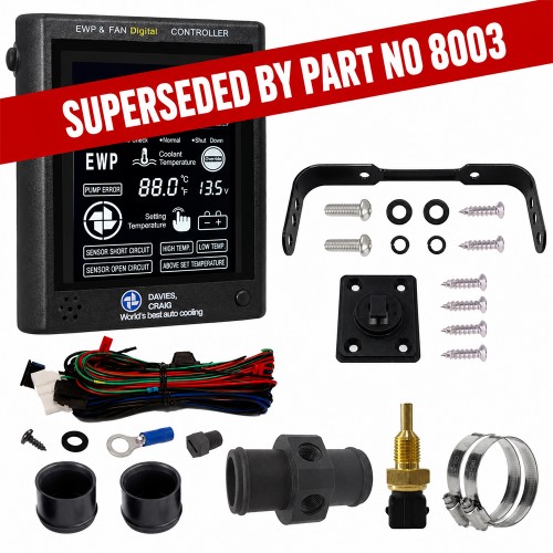

I use a simple on/off switch w/relay.Not sure from these posts how exactly you are running your electric pump but would this help? It appears you are running a set speed? Could be done via the ECU if aftermarket but this is self contained.
@Fabman & @Swiss Boss mentioned using a toggle switch to warm the motor first before the pump turns on, i can see someone getting distracted and coming back to a cooked engine. I'd be paranoid.
Given your exchange rate this would be cheap.
EWP & Fan Digital Controller Kit (8002)
Davies Craig Electric Water Pump (EWP®) & Fan Digital Controller Kit (Part #8002)daviescraig.com.au
I'm using something similar to that from Pierburg. It uses a dedicated temp sensor to ramp up pump speed based on temp. It's been super solid. Car heats up fast and stays cool.Not sure from these posts how exactly you are running your electric pump but would this help? It appears you are running a set speed? Could be done via the ECU if aftermarket but this is self contained.
Thanks!Looking damn good, as usual.
Awesome little unit, and i mean little. Nice to see what others use as i would have never come across it.I'm using something similar to that from Pierburg. It uses a dedicated temp sensor to ramp up pump speed based on temp. It's been super solid. Car heats up fast and stays cool.
I have mine set to try and maintain 186 degree water temps and it revs the pump speed up and down as needed. It's flawless. No thermostat needed. Offers a variety of options so you can set what works best for you.
