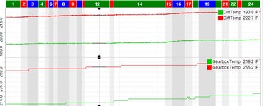

On the brightside, my new ducting was absolutely lights out. Even the though the temps were 10 degrees hotter than March and there was no wind, the car ran much cooler.
Oil temps dropped from ~230 to ~212 going back into the motor. The oil tank even saw a change from roughly 230 to 223-224 (this is the oil that is coming directly out of the engine).
Coolant temps were even more dramatic. Water temp is now running below 170 (down from 185). And my cylinder head cooling mod is doing wonders - with the water temp at the back of the heads measuring in the 170s - a fully 10 degrees cooler. This is having a good effect on the actual head temp as well - with the OEM sensor location (not exposed to water) reporting a drop from roughly 205 to low 190s.
This is pretty insane.
This wasn't just on lap 1-2 or anything. This data is taken from my 8th lap of flat out driving in 85 degree heat. At this point, I think I am overcooling the car a bit.
