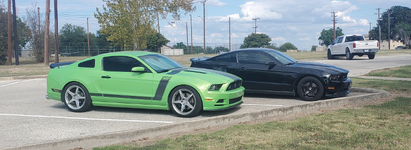

In a stockish Boss 302 with 18" wheels, 275/40 tires, stock Boss springs and Koni yellows, I scrape occasionally daily driving on not that bad roads in TX. For me, the parts that scrape are either the front splitter on inclines like driveways and ramps. Sometimes the side pipes scrape on areas of roads where there's an incline on one side and a decline on the other (the part that connects the H-pipe to the side pipes). I've decided I don't want to go any lower unless I go bigger on the wheels.

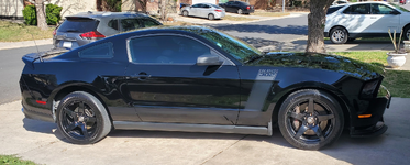

A guy I know has a '13 Boss, stock Tokicos, and FRPP T springs on 20" wheels. Somehow this all fits with 285/35 square tires, and his car sits higher than mine! I thought maybe my old stocker springs may have sagged but when I compare to others with the same springs, they seem fine. I decided it must be those 20" wheels. Together I think that'd make his car around 1/2 - 1" higher off the ground than mine. Not sure if he has rubbing. My guess would be that he does have some tire rubbing. He has very little visible gap between his front tires and fenders. Keep in mind, neither of us track our cars (yet).
Delicate balance for street cars I guess. Safest thing to do is probably to compare other's builds and copy the one you like.

Love that Boss! You dont see many in that green. So question for ya . If im going to do the occasional track days am I better going with nice 18s over 19s?
275/40/18 square on 18x9.5 or 10 is a great all round street and track setup. If buying just for track you want 18 or 19x11 and 305 square. Choose the tire and use case first and then buy wheels to fit. Some good tires are available only in 19” and vice versa.
My experience is that you want to consider your wheel size as a system with your suspension and tire setup. For my car, I think 18" takes me about as low as I am willing to go. I will say that my high speed stability is pretty good considering I'm on stock springs - and I think that the lowness of the car contributes to that. I do have a fat wheel gap in the rear b/c of the stock spring and 18" wheel combo:
If you go coilovers, you can pretty much choose your ride height so you have more freedom with your wheel size. On springs, if you go lower you're probably gonna need 19's. 20's are too big for most builds; will likely cause fitment issues especially with lowering springs. The serious race guys seem to use 18's or 19's. Drag race guys use even smaller wheel sizes so they can fit more meat in there.
As far as tires, 275/40 is a decent size for a dual purpose car. I'd say the size leans towards being more streetable, but is probably good as an entry level track tire for HPDE or autocross. With the right tires, 18x10 or 19x10 are a pretty safe fitment bet if you don't want to use spacers. A max effort race car will use 11" wide wheels or sometimes even 12" I think. As far as track tires go, the guys here will tell you that what you want is the widest tires you can fit on your car. After you've decided on the suspension setup you want, you can choose the type of tire and tire size you're going for and see what size wheels fit.
