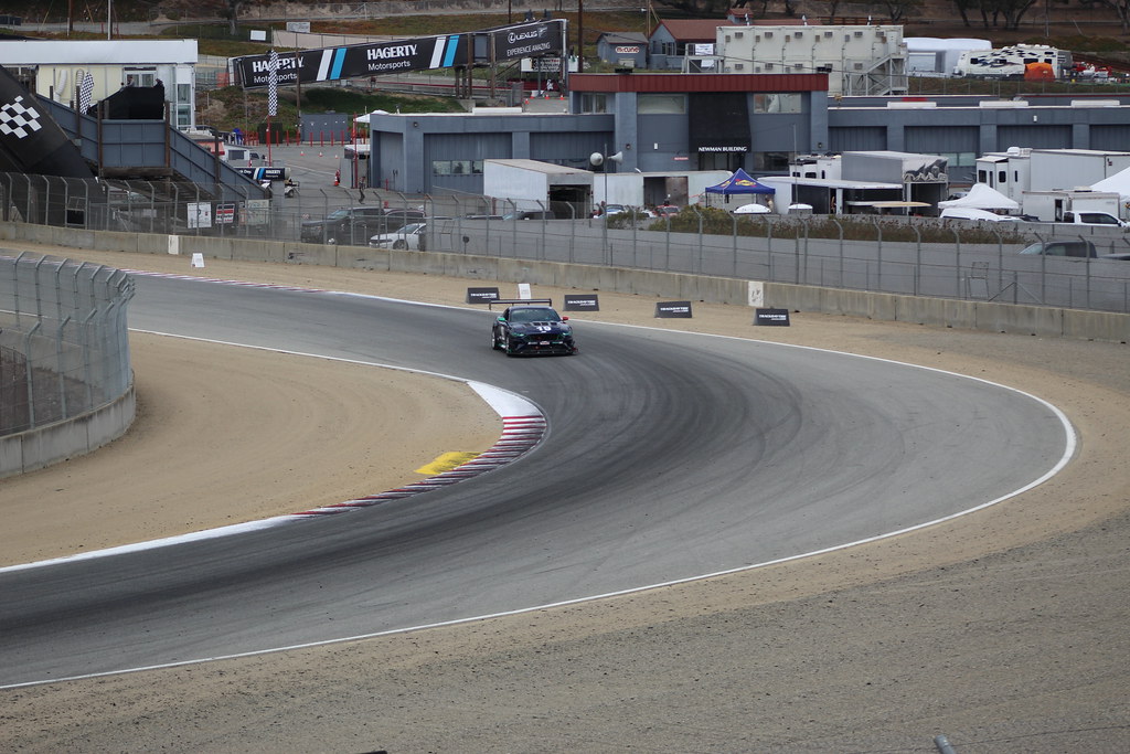

2022 Laguna Seca Nasa NATIONALS 2nd place.
I couldn't defend the title of last year Daytona.
1:32.8 my best lap. Less than 7 tenths from 1st place of Jake Latham and his great corvette.
He won also ST2 race with so many amazing passes. He deserves the glory.cause he is an awesome driver.
Mustangs are not meant for Laguna. All people say Laguna is a power track. I politely disagree.
Laguna is a track that loves light car with good torque. Some of his minimum speeds are insane. The corvette is 2800lbs vs 3700lbs of my mustang (with driver in).
i found traffic in 2 of my sessions during hot lap
En fact my 32.8 was done on lap 5 on session 3 at 4pm. I know i left lots on the table cause i did 32.4 in june (video to come). I also made some mistakes. But that is racing right? A combination of luck, good driving and good choices.
So small summary of what was good and what bad.
Good : fastest mustang around there (not including the TT unlimited with 800+ whp )
Met great people. I've learned more about my car. I love w2w
Bad: i didn't win 😅. Traffic. Didn't drive at the best .Car with issues.
