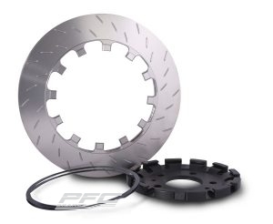

These are the best 2 piece rotors I have ever run and I have run giro's, brembo's, stoptech's
I wish more people would run them so we can get more rings. PFC produced these then low interest put them on the shelf unless you order in runs of 10
