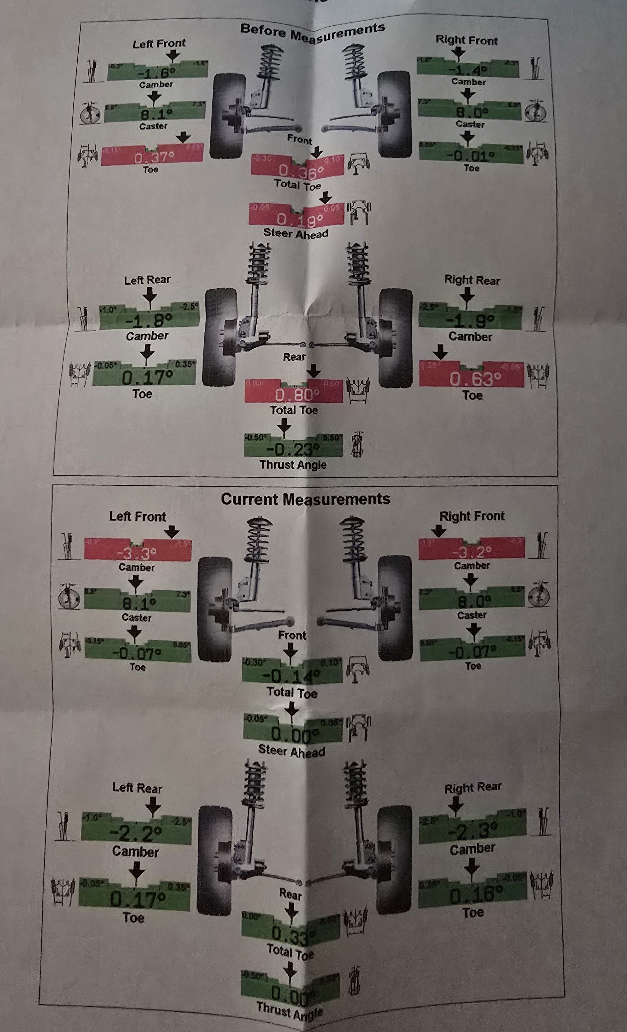

Plates themselves did max out @ 3.2 degrees, with the stock height CFTP springs.

I see red anodizing. Are those Vorshlag plates, or do stock GT500 camber plates look like that? (I am too poor for anybody even to let me peak into the strut hole of a GT500, so . . . ). I am mainly asking because you said the plates maxed out at - 3.2°
Vorshlag. Not sure how much of what I got applies to your S650 though.
And yes, Vorshlag plates max out at that with stock CFTP springs.

I have an older hunter alignment system. These were my numbers with vorshlag, strut pushed as far as I could go and still fit
cap on strut top (didn't bother with caster, as it's a PIA with my older system).
I cut top of strut vs cutting body, then got 3.2 (not sure if I have pic of alignment screen for that).......
