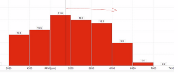

The green line is the CJ from the video with no other changes. The red highlight is the ported 2018. Its that linear gain from 6k to 6.5k then no drop off all the way out that is deal maker for me.

Even the hump from 5100 to 5600 would allow me to spend more time in a better hp zone. By extending the upper limit and being able to hold a lower gear i would effectively shift this graph to the right and spend more time at higher hp.
