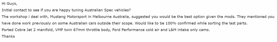

Called past Mustang Motorsport today and had a chat. The Aus & EU spec are a bit different but they knew that Roush, Lund and another knew how to deal with them. Because they are all standard common mods they suggested Lund as they have dealt with them previously. Off the shelf tune should get us 80-90% then we can do some dyno logging and get it tweaked. We are looking for gains but not every last hp so should be fine.
And this saga continues to get more annoying. At this rate i'll have the most modified "like its pretty stock really" un tuneable car on the planet.
Lund got back to me about an Australian car.

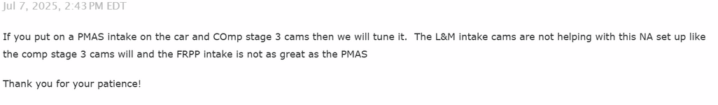

Don't quite agree with them telling me what options to use and all you guys with L&M Intake cams are obviously doing it wrong.
On a happier note, Lethal Performance came back with a revised quote and great shipping costs to the land down under. Sent them a massive amount of worthless Australian Dollars in return for a 1320 Junkie Ported manifold and VMP twin 67mm throttle.
I got what i could actually get my hands on.

The L&M cams are easy on valve train and have a nice broad powerband.
The Comp stage 3 make more power, but narrower power band and hard on valve train.
Great if you have a sequential, not so great with a regular transmission where the gears are father apart.

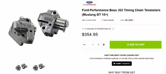

Pick up some Boss 302 Iron Tensioners and you should be good to go.

The part description made sense so i've already ordered them. I'm changing your name to Bad Influence.
Fits 2011-2016 5.0L Coyote engines. Designed for improved timing chain durability in high rpm applications. Used on 2013 Mustang Cobra Jet engine program. Includes a pair of primary chain tensioners and bolts.

To make you spend more money if it’s not too late. Add Ford Performance/GT350 primary chains
I don't know where he is in all this but this is the time to do the TSS billet crank sprocket and TSS Billet Oil Pump Gears.
I didn't use the GT350 chains in my gen 2 motor but did in my gen 2/3 motor I am currently running. (gen 2 heads/gen 3 short
Had the crank sprocket done when the GT500 sump and pump went in. Its a low KM engine which means its a really low Miles engine. ;)
Not to add to your list of woes, and hopefully it won't be a problem, but Ford for the last while has been shipping M-6266-M50B as a more complete kit that includes both primary and secondary timing chain tensioners (like it used to) but also now includes the Boss 302 specific articulating timing chain guides. This is because all other Coyote guides were running into clearance issues with the external ratchet and the chain oil feed hole is in a slightly different position compared to the Gen 2 articulating chain guides, so they thought it prudent to supply the matching guides. The Boss guides also have a beefed up design compared to the Gen 2 stock guides. Just double check that you receive the complete kit from whoever you ordered it from. You can see pics of the revised kit here:
