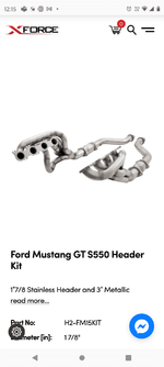

Now the car came with an X-Force 3' Cat back system with Varex mufflers so we can not get busted by our one small step away from 1939 Germany police here in Australia. Yes they are that bad when it comes to vehicles. They crush cars here. Can be funny buggers generally but the Traffic Operations Group have a bad rep.
Now while it might not make a great "race" system its already there and dual purpose car thing again. Oh, guess what, company just north of work had the headers for sale at a reasonable price and it should just bolt up to the rest of the system. Sounds simple enough.

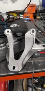

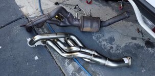

This led to some interesting questions. Like how the hell do these things make the power they do with these factory manifolds. Like how short can we make the primary.
The inside view is even worse.
And no the other side isn't any better
440782122_844418997523370_1517403133225647815_n.jpg440913323_973220030640089_2794883666193682286_n.jpg
Now i realise packaging is an issue but damn.

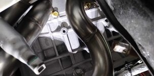

Actually i didn't realise packaging was that much of an issue until i had to fit the long tubes.
Us poor folks with steering wheel on the correct side get hit with the starter motor and steering shaft tax. Disconnect one and remove the other, half install headers and put other bits half back and continue.
I may have modified the engine mount to allow a pipe to rotate. I definitely walked away from this job on multiple occasions.
445668853_6295901487201577_3809667209070295374_n.jpg442445520_308823128953138_7410649313767223785_n.jpg436381208_480496024315507_6342388901634147463_n.jpg
Eventually and i mean eventually i got them in and bolted down. Except for one nut that i cant see or reach and get tight. Got it started before i lost access. Thankfully it has another stud really close that i could get done up. I'll keep an ear out for an exhaust leak and next time i pay someone to lift the engine and remove the left hand engine mount they can tighten the bloody thing.

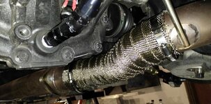

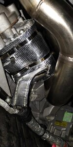

While is was there, thought i should protect the starter motor given it has a header looping around it. Coolwrap to the rescue. And some sleeving for the cables too it. And some more for the transmission oil cooler lines that were a tad close to the exhaust and the outer braid has slightly sizzled.
Might as well wrap the exhaust pipes where they wrap around the diff just to reduce the heat transfer.
