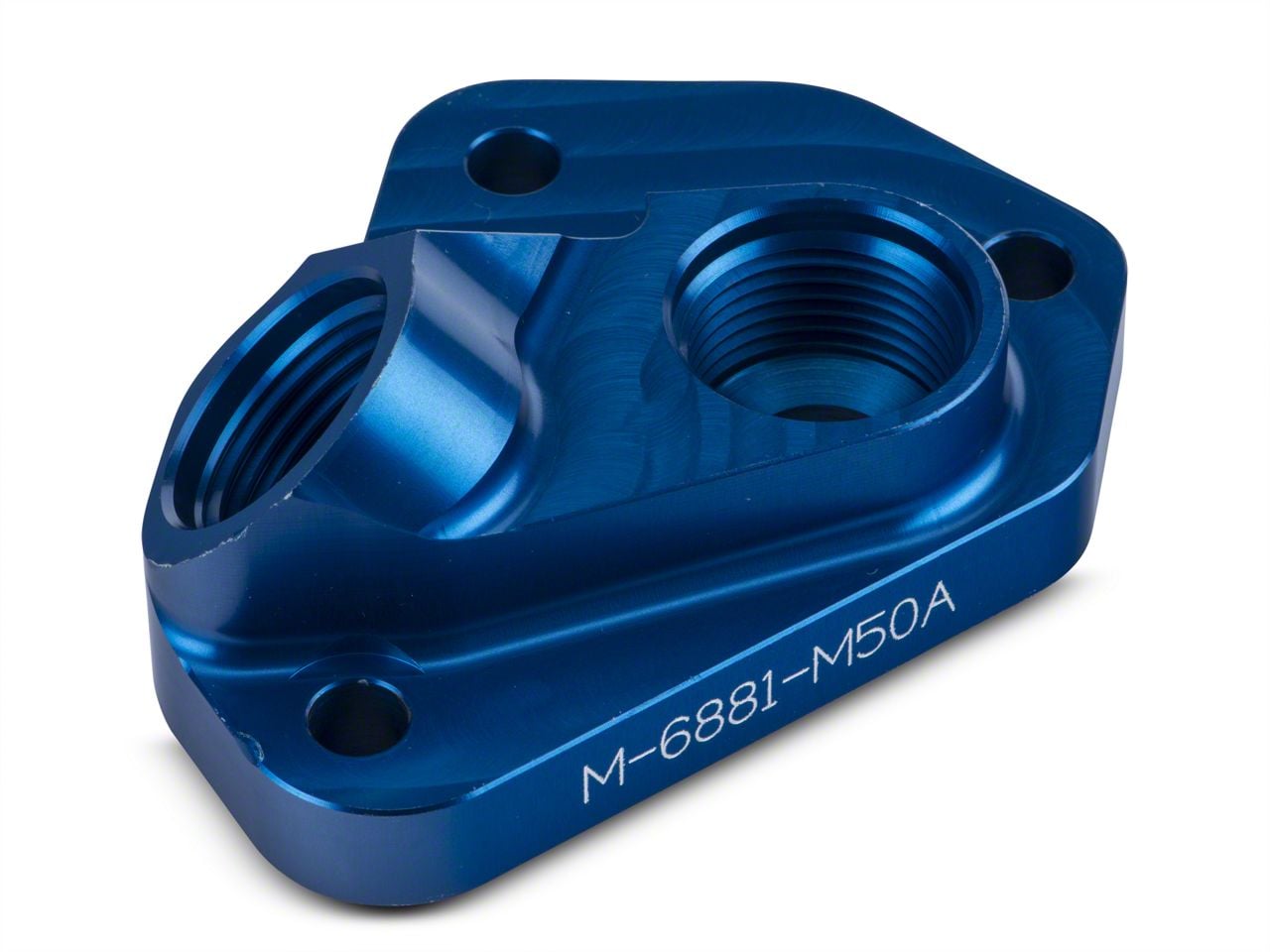

If you haven't already, pickup one of these.
Yes the gen 1 part will physically bolt up but there are differences in the sealing surfaces and it comes with -12 fittings. Ford specifically says to run -12 lines on gen 2 and 3 Coyotes. (not -10)
Also, I don't use a thermostat in race cars. Its just one more thing to restrict and divert oil flow unnecessarily.
Just -12 to remote filter, (I'm not a fan of sandwich blocks) then to the cooler with the fittings on top or side (never on the bottom) and back to the block with a minimum of angled fittings. That's it.
Thanks for that!! I just checked and the MMR one I have is -10 though all the lines are -12
