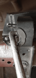

Exhibit 1

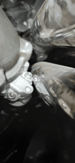

Exhibit 2,starter with header

Exhibit 1

That header tube banging on the starter could well be the culprit.
