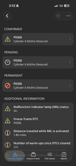

first track day yesterday with the full Gloc R12/R10 setup - felt good. got new pb and more consistent laps all day but thats probably just with more seat time. Not sure if I felt any difference with the track pads vs oems but I think the bottleneck at this stage would be tire grip. Unfortunately had to cut the day short with engine misfire on first laps in the afternoon when temps got up to about 80F and check engine light now on the dash.
How much fuel did you have in the tank and was it on or immediately following a left turn when it happened? At my favorite track there's a long sweeping left hander, and by 50% fuel at the end of that turn I would get a consistent misfire. It would clear up again once I was no longer turning left.
The initial workaround was to fuel it up before half a tank, and I then put in a KRM pump to try to correct that. We'll see how it does when I'm back next week, but all the reports I've read indicate it should fix the problem for me.

Also, what are you looking at with those codes? It looks like you have some sort of app on your phone?
Tank was full (just topped off before session). I refuel after nearly every other session and always keep it above 50% on track. Misfire occurred at end of track's longest straight. I should have it on video so I'll see if I can post the clip in a bit. KRM pump solution would be nice!

For the codes I was using OBDLink MX+ which I just leave plugged into the OBD port during track sessions and it has a nice mobile app that works well to read any codes.
Rev Limiter :? I would clear it and check if comes back. Always have a forscan ODB II with you in the car not sure if the new ones can clean errors via ODB though.
That doesn't sound like the standard issue that the KRM pump fixes. Basically the stock pickup is on the driver's (left) side, and so in long sweeping turns when the fuel sloshes to the right, and there's starvation. At the end of a straight with a full tank doesn't match. Let us know what the issue ends up being.
FWIW, I am looking at Apex wheels when there is a sale as well, for both the weight reduction vs. stock (and thus improved handling from lower unsprung weight) and also so I can run a square setup and rotate the tires to get more track life out of them.
Got a ford service appt for late next week to look at the check engine light- car will be resting in garage until then. before then I may look into Forscan to see if that can give me any other information as well. worth noting that on the same lap before the misfire the engine was pulling power as well- It wasn't really noticeable at the time, but looking back at the telemetry it's easy to see as the lap deltas climbed a lot during full throttle. video below - you can hear the misfire right before I cross the 'gatorade' bridge at around ~:24 timestamp.
