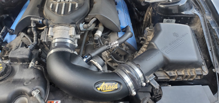

Here's a picture of the hose attached to an Airaid tube I used for a little while. It fits a little loose on the Airaid tube, but that's the tube's fault. The tube was designed for the GT and needs an adapter to work on the Boss manifold. But this is what it looks like. It fits snugly on the OEM Boss tube.

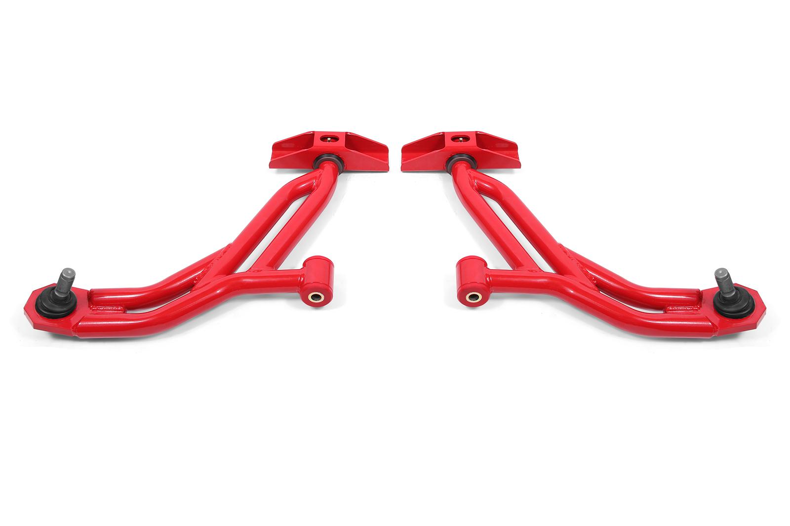

Can anyone identify these LCA's in the front? They appear to be BMR red, but I don't see them on their website.
Looks like BMR to me
download.jpgMaybe an older design?
