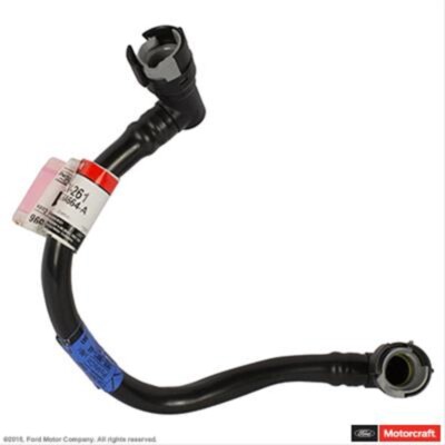

Now I'm looking for a PCV hose to get it smogged. CR3Z-6758-B. Discontinued and no one seems to have one. There's gotta be another one that fits.
Just the noise bothers me. I honestly couldn't tell the difference on my other car when I installed a WL on it. I will probably take it off and sell it. This car will be mostly street with some track days, maybe.
I used this one from LMR. I think it's the '15-17 part. Couldn't tell the difference from the original one.
Ford URL:
Part #: KCV255 (BR3Z6A664A)
