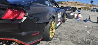

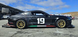

Well I wanted to fit 335mm tires all around and I got an ANDERSON COMPOSITE FENDER KIT to fit them. Thanks TERRY FAIR FOR THE HELP!
I installed the MMR 10speed kit for after market steering wheel. Now the car feels more... racecar! Thank you so much guys for the opportunity to be your tester.
And we'll not chassis but... I wrapped the car :) still not finished yet. But getting there
TIRES AND WHEELS
I went with a 335 mm A7 choice.
On a 18x12 APEX RIM. to fit under the huge fenders I needed huge spacers. 48mm front and 40mm back.
