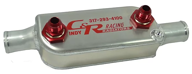

Anyone knows if i can "plug and play the oem fan plug? See pic
