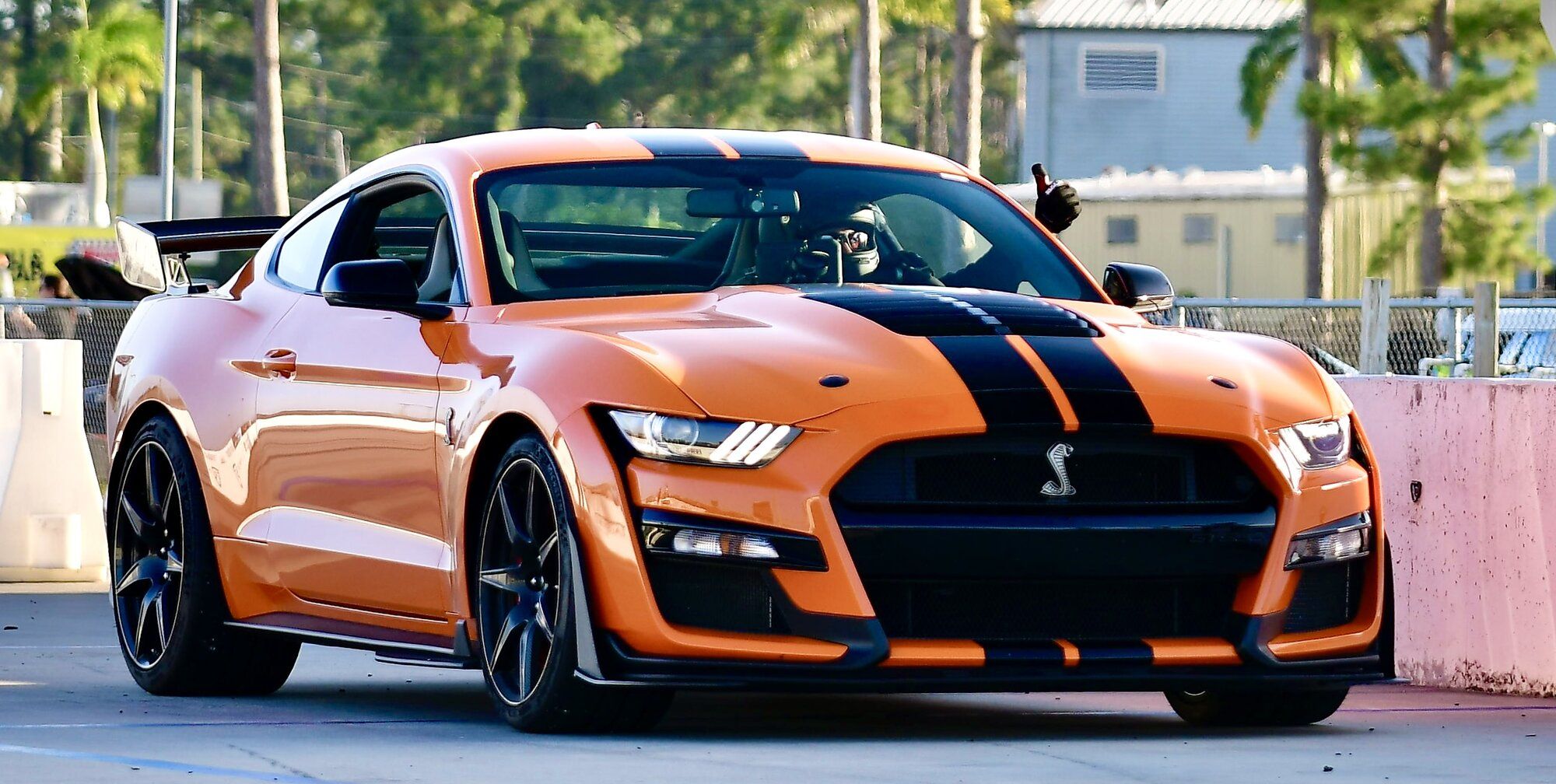

Since you converted to E85--how are you making it through sessions at big tracks like Daytona? I thought the 500 drained the fuel tank pretty quick on-track, and E85 is at least 30% higher consumption.
This was lap 5 (that's a ZL1 LE BTW :D). Lap 6 it fuel starved a bit going into the Bus Stop. I finished lap 6 at a fast enough pace to be fun and then cooled it off and came in. I didn't worry about getting it fully topped up before the session, because there'd been so much traffic and my fuel consumption was more moderate in earlier sessions...stupid. I think I missed out on 1-2 full paced laps, and probably a faster lap time. I could've got 1 more at pace had it been totally full.
This had me looking into trunk tire well fuel cells as a supplement. But then I've got fuel in the trunk, and I like fold down seats so I don't want to build a firewall. I can put my bicycle in there, and I also actually have a full size spare in the spare tire well.
This car is really just about fun; this is decidedly *not* the setup to maximize driver development or lap times. On E85 it makes crazy power safely, the fuel is tons cheaper, and doesn't get too hot no matter ambient temps. If I miss out on a few laps per HPDE day because I have to come in 1 lap early, is that really a big deal?
EDIT- Also, I currently don't plan to go back to Daytona with this car. It's easily a 190MPH car now, and if I am there, I'm going to try for it. That's too damn fast without a cage etc.
