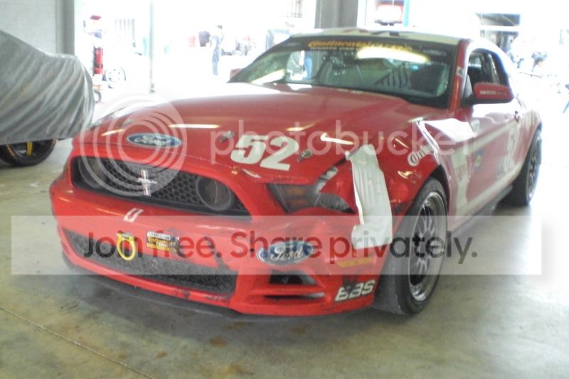

Aluminum is your friend. I have not seen the covers for sale but you might be able to buy them from one of the race teams. Here's the best photo I have and Andy might have a better one.

I wish I took better pictures of the 52 car when they had it apart. The guys were working on this since the car took a few shots to the nose at HMS and they were worried about the effect on cooling since some of the work they did was damaged. Anyway it was just fabricated to close off any way for air to escape between the grille and radiator. I have been thinking about ways to do this to mine when I get the time. Right now I am worried that I changed airflow with the skid plate I built between the splitter and condenser/radiator. It is still closed off pretty well but any little opening will allow precious air to by-pass the radiator.
