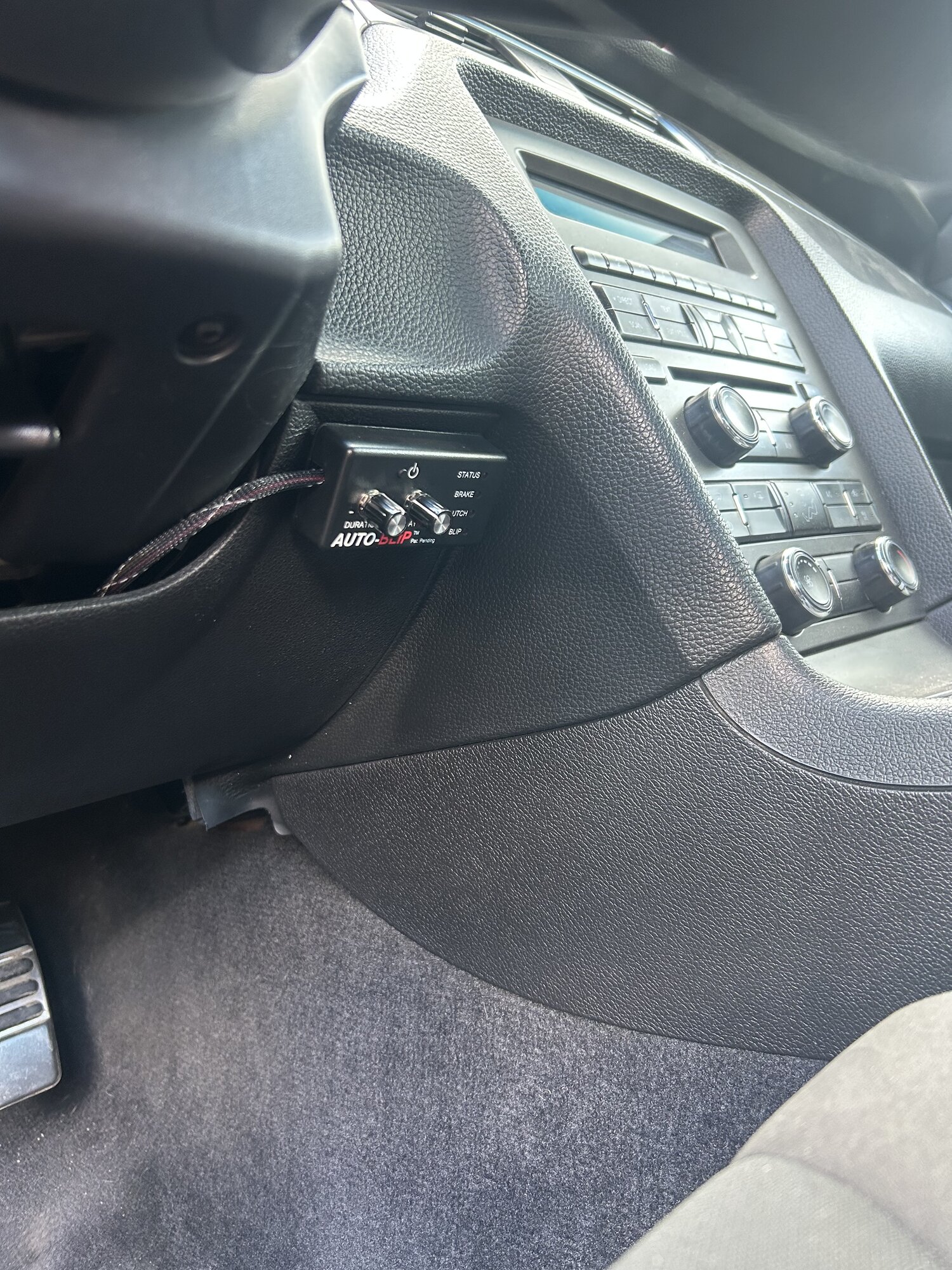

Finally got to try it out at a local SCCA Track Night here. Ran with the novice group for a couple of laps trying to get it adjusted to my liking. Had it coming in too late at first, dialed it in to blip sooner. Did the rest of the night with the main group. Only problem was that the delay knob moves so easily that it change a little on me during the sessions. Need to figure out how to keep it from moving so easily.
Dave
Where did you mount the unit? I have mine in the console and use Velcro tape to hold it where I need and can still remove to fiddle with it.
Console just above shifter with velcro Also I just saw old posting on using little o ring under knob to give it more friction. Tried that and works fine. knob stays where I set it.
