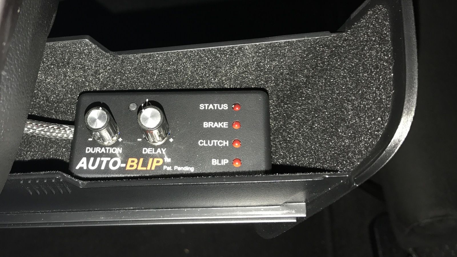

Installed today, calibrated and tested on the street. Looking forward to using at an hpde. I installed in the rear console box. Tmsboss, thanks for letting me know how easy the front console comes out. Just lifts right out - wow. Hardest part was removing the electrical tape after removing the connectors. Wow they taped the wires and also taped the black protector sleeve to the wires too. Did not want to use any scissors for fear my bad eyes and poor lighting I would cut the wires. I wound up using a head lamp because those colored wires were hard to make out. Also it was a real juggling act trying to place the wire clips and clamp them with the pliers. Probably took me twice as long as everyone else and it probably would have gone faster if I removed the seat. I used a garden ground pad under my back and just slid in under the wheel.

I thought the AutoBlip TMO reviews were positive so I ordered one and installed it a couple days ago on my 2007 Saleen PJ. As per some posts, it was easier to remove the driver's seat and add some padding to the floor. Instructions were clear for install as well as calibration. The short ride I took after installation seemed to indicate that the "delay time for me was best set at minimum as I mostly use my Saleen for the track.
I did note the the two adjustment knobs for "Duration and Delay" had no detents or clicks and it was too easy to shift the knob setting. I slipped an O ring over each knob and the knob position now has much more resistance to turning. I took the easy route and installed it in the console storage box. The O rings were 6mm ID and 2.5mm thick.
Nice tip on the o rings.
