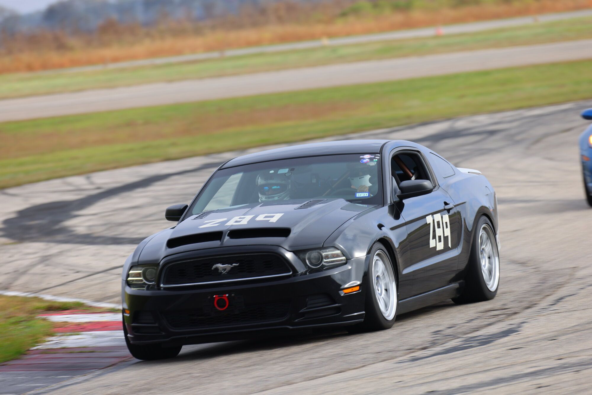

A vented hood will be better than stock at high speeds for those issues, not sure how much you can quantify that but the principles are sound.
You are correct that increasing the rear ride height will help to shift vehicle balance toward neutral or oversteer compared to your current setup (as you are "extending" the lever that the weight of the car has on the rear suspension), but again, this will likely have the biggest effect in the corner entry phase as opposed to mid-corner.
You should put a test plan together of things to try and aim to change settings and figure out how the car works with each of those settings during your next track day. Stick to your plan and resist the urge to knee-jerk adjust "the other way"; you can do that after you have gathered your data. If you find things that don't work, you are still learning something useful.
Excellent sir, I will work on my plan to make the car behave more neutrally. Currently I can adjust slow speed rebound dampening and camber very generously. Give me a couple of weeks and I will present my test methodology so you (and other TMO members) can provide suggestions as to how to go about making my car more neutral. I would also like to add that after reviewing my track vidoes, I do indeed have corner entry understeer in off camber corners. I plan to purchase an AIM solo 2 DL to gather as much data as I can (and interpret) to advance in a more educated and scientific way.
Learning is a life long adventure.....savor all its offerings!!.......the dumb one misses his opportunities to move foward..................................;)
Of course! I have had a few spin outs and off road excursions and have learned to not make the same mistake twice...well..this past weekend I did spin out twice in the same spot but I shall leave that behind:ohdamn:
If you're not already doing maybe trail braking in the corners where understeer is present would help shift a bit of weight forward and help rotate the car.
Yes sir, trail braking was a helpful friend in short ~3-5 second corners, but in that sweeper which is about 15 seconds long it did get annoying TBH. Every time I go to the track I fall in love with trail braking all over again. ROTATION!
Mid-corner ON throttle or OFF throttle? Makes a big difference...
Have you made the apex and are getting to the gas...but you need to add wheel because you are pushing wide when the weight transfers aft/lose front grip?
Or ...or are you about to make the apex but see that you need to add wheel because you are pushing wide w/o touching the gas...too much energy at front contact patch?
So it is mid corner ON throttle. The apex of this particular turn ('The Carousel' going CCW in MSR Houston) is very late, about 75% of the way through the turn. I will post a video below to help me illustrate.
The understeer happens ~2-3 seconds before hitting the apex while on the gas so I must release the gas slightly to make the apex. On corner exit the car rotates nicely as I apply throttle.
It appears that your last statement represents more closely what is happening to me.
In the 2nd video (after the adjustments) you can hear me releasing the throttle (from ~85mph to ~80mph on the speedo) because the car is pushing and am going to miss the apex.

Excellent sir! At my home track I am keeping up with Porsche Caymans and Boxsters in the Blue Solo group (on a Green, Blue, Yellow, White scale). The car is super fun to drive at my limit! I have thought about making the jump to the BOSS 302 module. Do you know if it makes a significant difference (ABS-wise) with 200tw tires, say Falken RT660? With regards to Advancetrac, I plan to do the #5pin mod. If that proves to be undesirable, I shall hit up Ortiz when I need a tune update after I install long tube headers this Spring.
And progress you will see! I have a feeling I will be upgraded to the Yellow run group on my next event. There will be much faster drivers there!
So this is me understeering, It is not a lot but it was terrible before adjusting my rebound and camber slightly. However, my adjustments only fixed what I would say is ~60% of it.
This is how bad it was before adjusting.
This is after increasing camber from -2.5 to -3.1, and changing rebound damping at the front from 5 clicks to 10 clicks out of 24. To me it got about 60% better.
Watching both videos you also appear to have a better line in the second one ( imho ) but there are other dynamics that can affect understeer and oversteer, with a primary one being the tires. I did not see mention of what tires you are running ( in the two videos), what temperatures they were at, etc. Frankly with the Nankangs or the Federals you could simply have issues with them heat cycle wise ( getting old ) or the length of your track session. I have seen guys play with their suspension all day , trying to correct various issues they perceived and it was a simple case of the tires were toast or at the end of their fast cycle. The tires still had life in them tread wise, but they were inconsistent on the track.

AZBoss is quite correct about the hood vents , or getting a hood ( check out chicane23.com as he is the supplier for everyone else selling Tiger hoods ) to help with downforce, but even more so in your part of the US, it will cut down heat. PS- chicane23 does not list their hoods as " Tiger hoods " but they are exactly that.
Saw the vid...as @ArizonaBOSS said, the car is settled. That leaves you with 4 main variables: tire condition/capability, ride height, throttle position and wheel input.
1. Soft hands...wheel looks ok/line ok.
2. Neutral throttle...looks/sounds mostly ok w/o knowing tire condition (assuming lowish front grip...per your braking stories) .
3. Tires are a wild card....IMO, I'd replace them if you believe that they're nearly toast/$hit baked. First rule of racing is (as Bill said)....never chase setup on worn/dead tires. Never.
4. Once on new tires...get the temps in the window, go log sector times and determine if you now have only that same issue...or none...or more. Pay attn to how you put wheel into the thing. Soft hands, smooth, decisive inputs.
Bring back your issues list and let's see where you land.

Yes sir, the line is certainly better in the 2nd video. At the moment I was running the tires right around 36 hot. But, if I am honest, they are pretty shot. I actually had the both front tires on the outside or inside (can't remember which one) thread begin to grind out (has the appearance of ground meat). I am very glad that you and the other guys pointed this out because I did not take in consideration the condition of my tires. However, they have always pushed like this in event's past (although I have always run in ~80-90F ambient temps, this last time it was ~50F), with similar settings; so, I believe my issue is not only the tires but setup as well.
And yes, I do eventually want to sell my Cervini hood and cut a hole in an oem hood to go more function than looks! I have been looking at possibly making my own vents, my budget is relatively low at the moment.
