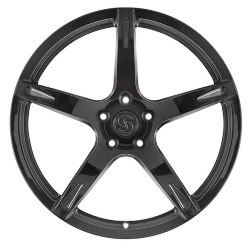

@Champale - what rims are those? 19s or 20s?
Hey Adam - they are Signature Wheels SV901s in 20x10.5 ET42 up front. I weighed them and the fronts were barely 22lbs. I'm pretty sure a 19 would have fit, too - those wheels have tons of clearance in all directions for the brakes.
