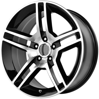

Probably, what is going to happen here, is my 07 Gt500 wheels with the new Goodyears will end up on the car, either that or they will end up back on the Shelby and those will end up on Superbeater with new rubber.
Although, the drifts do look pretty zoomy on the shelby. They are 18x10s
The 500 wheels will look classic and super nice on the build. You have new rubber on them. What the heck -run for a couple years and see what happens. Who knows what kind of deal will pop up. People are always wanting to go bigger. I bet someone out there bought apex or other racing wheels 18 x10 s in the past and are hungry for a new design or wanting / needing something wider and will need to free up some cash....
