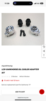

Did a few things prepping for Ozarks July 4 weekend. Some serious and 1 for fun. Pulled the whole remote oil filter assembly and the mile of associated hoses and installed the Dark Horse R filter/cooler adapter with a few parts from @Black Boss and the -12 adapters from Capaldi Racing who fabricates them for the program. Took about 3 pounds out and really simplified the hoses and oil path. One thing to ensure is to use the oil pressure sensor appropriate to your specific car. I had the S650/DHR sensor in the adapter and it plugs right into my S550 connector. But upon start up the gauged pegged to 100 psi+, which isn't unusual but there was no movement at all which is. Then I got a LOW OIL PRESSURE warning light which scared me for a second but I knew wasn't real. Shut it down and painfully swapped sensors as access is limited but got it done fired it up and all is normal.

Is this the oil adapter you are using? I ask because I contacted Capaldi a few years ago about it and how they got the oil pressure. I would prefer to use it but would know where to get pressure from if I don’t have available ports on the filter relocation mount(Improved Racing). I prefer to use this over the ford performance adapter.

Those are the fittings that make it -12AN compatible. You still need the S650 Dark Horse oil filter adapter to bolt these to. The Ford Dark Horse oil cooler uses push in pipes that are retained with screws into the block. The part from Ford is $350 +/-, the Capaldi fittings add about $150 more. Oil pressure comes on the block adapter as stock, it is a metric fitting, which is 2018 and up.
Ohhh. I’m an idiot. I thought they go directly to the block. They came on the FP350S too I believe. I see how everything connects now. Thank you.
