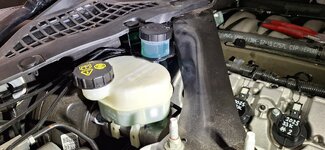

With the clutch booked in to be changed for the Hyper Single, thought i should do my bit and divorce the clutch system supply. All you guys used our Commodore reservoir but with the killing off of General Motor Holden in Australia, guess what, the price of one here is now $120.
Ended up with a Brembo one from Superbike spares with 45ml capacity. Being on the wrong side also made it a b*tch to find a nice spot to mount.
Found a wreckers who realized there are a truck load of crashed mustangs so you can move stock by not ripping people off. $30 for an automatic brake master cylinder with reservoir attached. I only wanted the reservoir. Cheaper than what i paid for the bike reservoir.
Google was listening in and sent me an ad for a VW Camper Van supplier with cloth braided brake hose with enough length. Once again way cheaper than everything else i'd found. Best part was with a slight trim of the braid allowed it to fit over the master cylinder nipple and still be small enough to be tight over the reservoir outlet.
Quick bit of cardboard design and some scrap aluminum bent to suit, mounted with a trim plug from the scuttle panel and just rests nicely on top of the brake reservoir. Quick phone video under the bonnet and it did clear with a bit of space, not a lot but as they say, a miss is as good as a mile.
While we were there, changed the brake fluid out for some race fluid, Penrite 600, its an australian brand. Does good oils as well. The stock fluid has done well given i think i have got those GT350 brakes pretty warm. Son got to help bleed his first brake system, well sit in the drivers seat and push, hold, release.
Quick drive round the block and it stops and still changes gear. I'm not totally incompetent it appears.

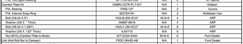

Watson Racing had some major price drops on some items and i needed a way to get some camber back that was lost when i went to wider wheels.
I had to dial back the settings on the hub for the wheel to clear the strut and spring but had maxed out my camber plates that came with my shocks.
Thanks to Pete @ Watson Racing for putting up with me and organizing overseas delivery for me.
Can put these in while the car is back up in the air. Unfortunately its back up in the air.

How are you adapting these to fit your coilovers?
Do you have the mis alignment spools for the spherical bearings?
No idea and no in that order.
In all seriousness i grabbed the major component because i don't really have many options in Australia.
The rest can be sorted out once i pull everything apart and work out what hole i have dug for myself.
I did already think that the shaft diameter may be an issue but figured a sleeve was an easy fix. Was going through the FP350S parts list and other docs last night looking to see if there were other parts that i could reference.
@steveespo interesting that they don't mention those parts. If you have any pictures i'd love a look just to see what was meant to go in there. Either way i see something custom in my future. Metric shock absorbers into imperial bearings already sounds a mess but such is life.
Hoses are already out so I can send them for a trip interstate to Motorsport Connections who will do me a set of custom crimped hoses using mine as samples. Same guys who do all the V8 Supercars so they will be way better than my effort and they get pressure tested after manufacture so it's another item I shouldn't need to worry about.
multimatic bearung spacers.jpg This is the front pair for the Multimatic DSSV shocks I put on my car. 5/8"bearing bore, 16mm"shaft. I only had one set, (long story). Getting them from Multimatic is theoretically possible but no time line given and $$$$$. So I ordered 5/8"mis alignment spools that were the correct heights (very close) from QA1 products. Perfect fit for the bearing, .005" tight for the shaft. What to do? Backyard lathe, chucked the new spacers into my drill press and then used a carbide burr to open the bore a little at a time, stopping often to test fit onto the shaft. Material is very hard so it was slow going even just taking 5-6 thousands. I would call Watson, they are great and will help you figure what you need. Just let them know what shock shaft diameters and the bearing bore diameter.

View attachment 108689 This is the front pair for the Multimatic DSSV shocks I put on my car. 5/8"bearing bore, 16mm"shaft. I only had one set, (long story). Getting them from Multimatic is theoretically possible but no time line given and $$$$$. So I ordered 5/8"mis alignment spools that were the correct heights (very close) from QA1 products. Perfect fit for the bearing, .005" tight for the shaft. What to do? Backyard lathe, chucked the new spacers into my drill press and then used a carbide burr to open the bore a little at a time, stopping often to test fit onto the shaft. Material is very hard so it was slow going even just taking 5-6 thousands. I would call Watson, they are great and will help you figure what you need. Just let them know what shock shaft diameters and the bearing bore diameter.
Big thanks for the pics, gives me a great indication of what i'm aiming for. Will see if i can drop a shock down tonight and get some measurements. Most likely i'll get something machined up as the spherical bearing is imperial internal measurements and my shock will be metric as they are european ST (low end KW).
