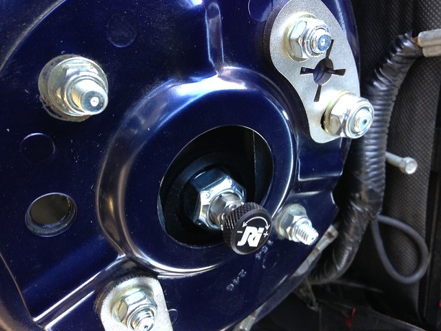

CorteX/JRi DA rears, 18mm sway and Eibach LCAs installed.
Not sure if the adjuster should have been mounted facing in or outboard:
If you mount them inboard (ie: Facing towards the pumpkin), they can be adjusted without pulling the wheels off. If you mount them outboard, it's easier to adjust with the wheel off.
For those smaller adjusters, it's kinda just a preference of which you prefer to do. No real right or wrong.
Thanks for the reply. That's what I was thinking while I was putting them in. Mounted them facing outboard because I figured I'd have them set when I swap wheels/tires. Might opt for a 5-spoke wheel next like CF5s so I can reach through.

Did the front today:
Took a couple of short test drives, and the difference in grip is a-freaking-mazing!
