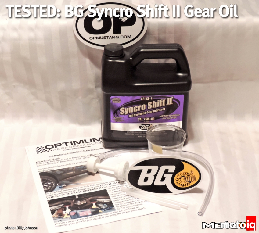

I am sure nothing new here. Stock MT82, 90k miles. Who knows what's in there now. When cold there is a slight notchy feeling going into 2nd and 3rd. Shifts slow as well. Once warmed up seems OK. 1st oil change, trying the BG syncro shift based on the below and some other posts.
Will report findings.

BG Synchroshift II is what I use for racing Sal. When you drain do it through a paint filter, any black plastic like grains are synchro material and indicate wear. They typically don't shed metallic particles unless there is some significant damage.
This is a street car....same fluid?
Order with MGC additive no no additive?
I have run the additive but don't see the need and never felt any difference. I speculate it is an additive package that wasn't in the original spec Motorcraft fluid that they added as a band aid to slow down warranty claims. Wouldn't waste money on it.
