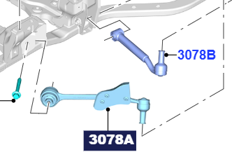

Does some one have torque spec for these two front suspension components? I believe the part numbers are FR3Z3079H, FR3Z3078E. Its for 2017 GT350.
Shop manual shows same procedure for both.
3078A
Install inner bolt finger tight
Install the new front lower arm outboard nut. Torque: Non SVT: 85 lb.ft (115 Nm) - SVT: 76 lb.ft (103 Nm)
Set suspension to road height. Inner bolt Torque: 184 lb.ft (250 Nm)
3078B
Install the new rear lower arm outboard nut. Torque: Non SVT: 85 lb.ft (115 Nm) - SVT: 76 lb.ft (103 Nm)
