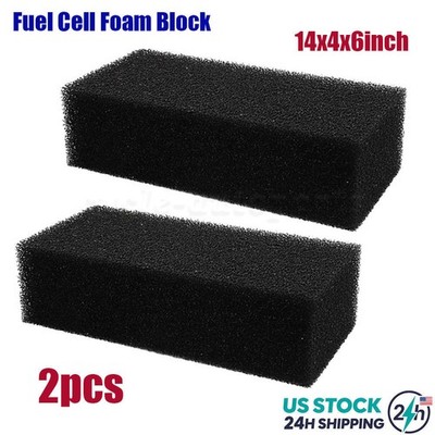

It really didn't I crammed it into the saddle portion of the tank to prevent the back and forth sloshing ( at least I hope) fuel will still pass, and it will absorb fuel, but it won't have the free flow effect back and forth between the tanks.
For reference for me and other guys in the future. Is this fuel foam size big enough for the saddle cross over? The price seams pretty darn good to help potential solve a major issue and only decreases fuel capacity by 3%. You, also, installed a Delphi fuel pump. Was that an upgrade or just a replacement?
That looks exactly like what I bought , I had already done the pump, but I broke one of those plastic tubes that are belched from the pits of hell, so I just replaced everything. I would've prolly preferred a Bosch pump, but none were available. The pump was a stock replacement.
